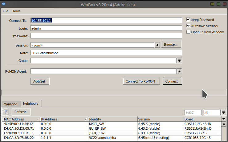

Simple mode
When you open the WinBox loader for the first time, the simple mode layout will be used:
To connect to the router, enter the IP or MAC address of the router, specify the username and password (if any) and click on the Connect button. You can also enter the port number after the IP address, separating them with a colon, like this 192.168.88.1:9999. The port can be changed in the RouterOS services menu.
warning
It is recommended to use an IP address whenever possible. A MAC session uses network broadcasts and is not 100% reliable.

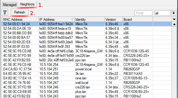

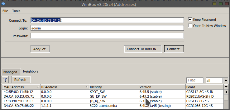

You can also use neighbor discovery to list available routers. Use the Neighbors tab:
From the list of discovered routers, you can click on the IP or MAC address column to connect to that router. If you click on the IP address then the IP will be used to connect, but if you click on the MAC Address then the MAC address will be used to connect to the router.
info
Neighbor discovery will show also devices that are not compatible with WinBox, like Cisco routers or any other device that uses CDP (Cisco Discovery Protocol). If you try to connect to a SwOS device, then the connection will be established through a web browser

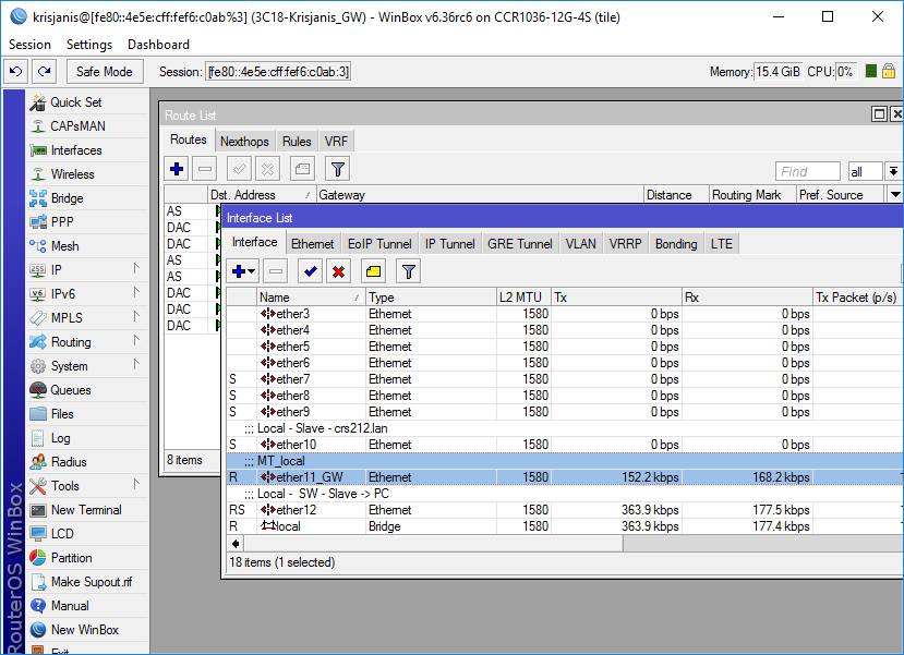

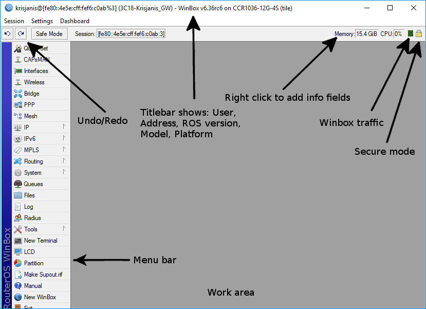

Interface Overview
The WinBox interface has been designed to be intuitive for most of the users. The interface consists of:
  • The main toolbar at the top where users can add various info fields, like CPU and memory usage.
  • The menu bar on the left - list of all available menus and sub-menus. This list changes depending on what packages are installed. For example, if the IPv6 package is disabled, then the IPv6 menu and all its sub-menus will not be displayed.
  • Work area - an area where all menu windows are opened.
The title bar shows information to identify with which router the WinBox session is opened. Information is displayed in the following format:
[username]@[Router's IP or MAC] ( [RouterID] ) - WinBox [ROS version] on [RB model] ([platform])
From the screenshot above we can see that user krisjanis is logged into the router with IPv4/IPv6 address [fe80::4e5e:cff:fef6:c0ab%3]. Router's ID is 3C18-Krisjanis_GW, currently installed RouterOS version is v6.36rc6, RouterBoard is CCR1036-12G-4S and platform is tile.
On the Main toolbar's left side is located:
  • Undo
  • Redo
  • Safe Mode
  • Currently loaded session
More about Safe mode and undoing performed actions can be read in this article.

Work Area and Child Windows
WinBox has an MDI interface meaning that all menu configuration (child) windows are attached to the main (parent) WinBox window and are shown in the work area.
Child windows can not be dragged out of the working area. Notice in the screenshot above that the Interface window is dragged out of the visible working area and a horizontal scroll bar appeared at the bottom. If any window is outside the visible work area boundaries the vertical and/or horizontal scrollbars will appear.

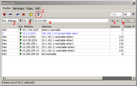

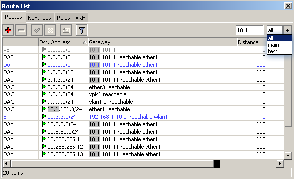

Sorting out displayed items
Almost every window has a Sort button. When clicking on this button, several options appear as illustrated in the screenshot below.
The example shows how to quickly filter out routes that are in the 10.0.0.0/8 range:
  1. Press the Sort button.
  2. Choose Dst.Address from the first drop-down box.
  3. Choose in from the second drop-down box. "in" means that the filter will check if DST address value is in range of the specified network.
  4. Enter the network against which values will be compared (in our example enter "10.0.0.0/8").
  5. These buttons are to add or remove another filter to the stack.
  6. Press the Filter button to apply our filter.
As you can see from the screenshot, WinBox sorted out only routes that are within the 10.0.0.0/8 range.
Comparison operators (Number 3 in the screenshot) may be different for each window. For example, the "IP Route" window has only two: is and in. Other windows may have operators such as "is not", "contains", "contains not".
WinBox allows building a stack of filters. For example, if there is a need to filter by destination address and gateway, then:
  • Set the first filter as described in the example above.
  • Press the [+] button to add another filter bar in the stack.
  • Set up a second filter to filter by the gateway.
  • Press the Filter button to apply filters.
You can also remove unnecessary filters from the stack by pressing the [-] button.

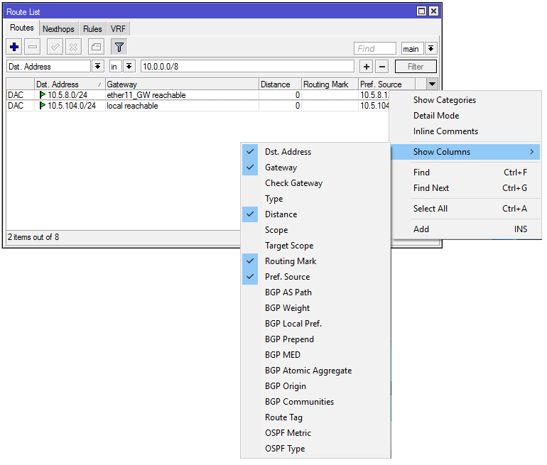

Customizing list of displayed columns
By default, WinBox shows the most commonly used parameters. However, sometimes it is needed to see other parameters, for example, "BGP AS Path" or other BGP attributes to monitor if routes are selected properly.
WinBox allows you to customize displayed columns for each individual window. For example, to add the BGP AS path column:
  • Click on the little arrow button (1) on the right side of the column titles or right mouse click on the route list.
  • From the popped up menu move to Show Columns (2) and from the sub-menu pick the desired column, in our case click on BGP AS Path (3).
Changes made to the window layout are saved and the next time WinBox is opened the same column order and size are applied.

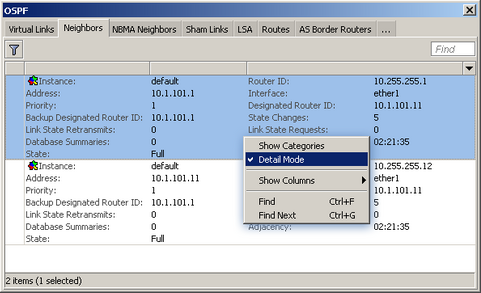

Detail mode
It is also possible to enable Detail mode. In this mode all parameters are displayed in columns, the first column is the parameter name, the second column is the parameter's value.
To enable detail mode, right mouse click on the item list and from the popup menu pick Detail mode

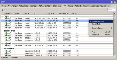

Category view
It is possible to list items by categories. In this mode, all items will be grouped alphabetically or by another category. For example, items may be categorized alphabetically if sorted by name, and items can also be categorized by type like in the screenshot below.
To enable Category view, right mouse click on the item list and from the popup menu pick Show Categories.

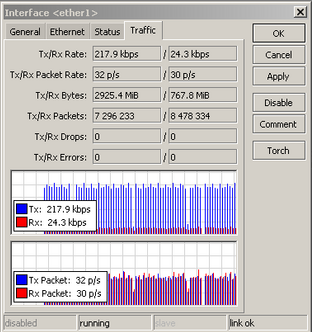

Traffic monitoring
WinBox can be used as a tool to monitor the traffic of every interface, queue, or firewall rule in real-time. The screenshot below shows Ethernet traffic monitoring graphs.

WinBox cannot connect to the router's IP address, devices do not show up in the Neighbors list
Make sure that the Windows firewall is set to allow WinBox connections through Private and/or Public network interfaces in the Windows firewall. It can be changed in Control Panel\System and Security\Windows Defender Firewall\Allowed applications. Or disable the Windows firewall.
I get an error '(port 20561) timed out' when connecting to routers mac address
Windows (7/8) does not allow MAC connection if file and print sharing is disabled.
I can't find my device in WinBox IPv4 Neighbors list or MAC connection fails with "ERROR could not connect to XX-XX-XX-XX-XX-XX"
Most of the network drivers will not enable IP stack unless your host device has an IP configuration. Set IPv4 configuration on your host device.
Sometimes the device will be discovered due to caching, but MAC connection will still fail with "ERROR: could not connect to XX:XX:XX:XX:XX:XX".
warning
WinBox MAC-ADDRESS connection requires an MTU value set to 1500, unfragmented. Other values can perform poorly - loss of connectivity can occur.
